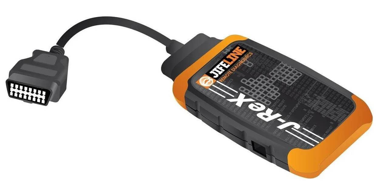

    Opel Corsa-D P1632 -00, P1678 -00 and P1679 -00 - Jifeline
    Do you have an Opel Corsa-D in your workshop that will not start after the battery has been dead? Often this fault is associated with the following combination
    jifeline.help

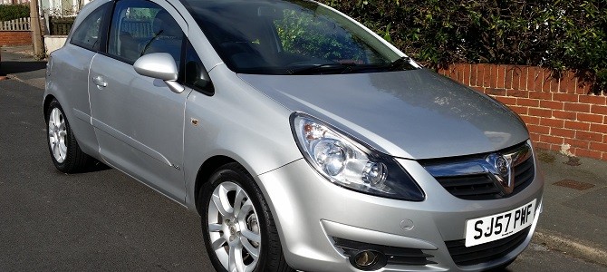

    Vauxhall Corsa D - Car Won't Start After Flat Battery - Immobilised - P1632 / P1678 / P1679 / B3114 / B3925 / B3929 / B3977 - AutoLox
    NOTE 1: Please check our  ‘areas covered’ page to see if you fall within our catchment area. We do not travel outside of this set area. Customers outside this…
    autolox.co.uk
